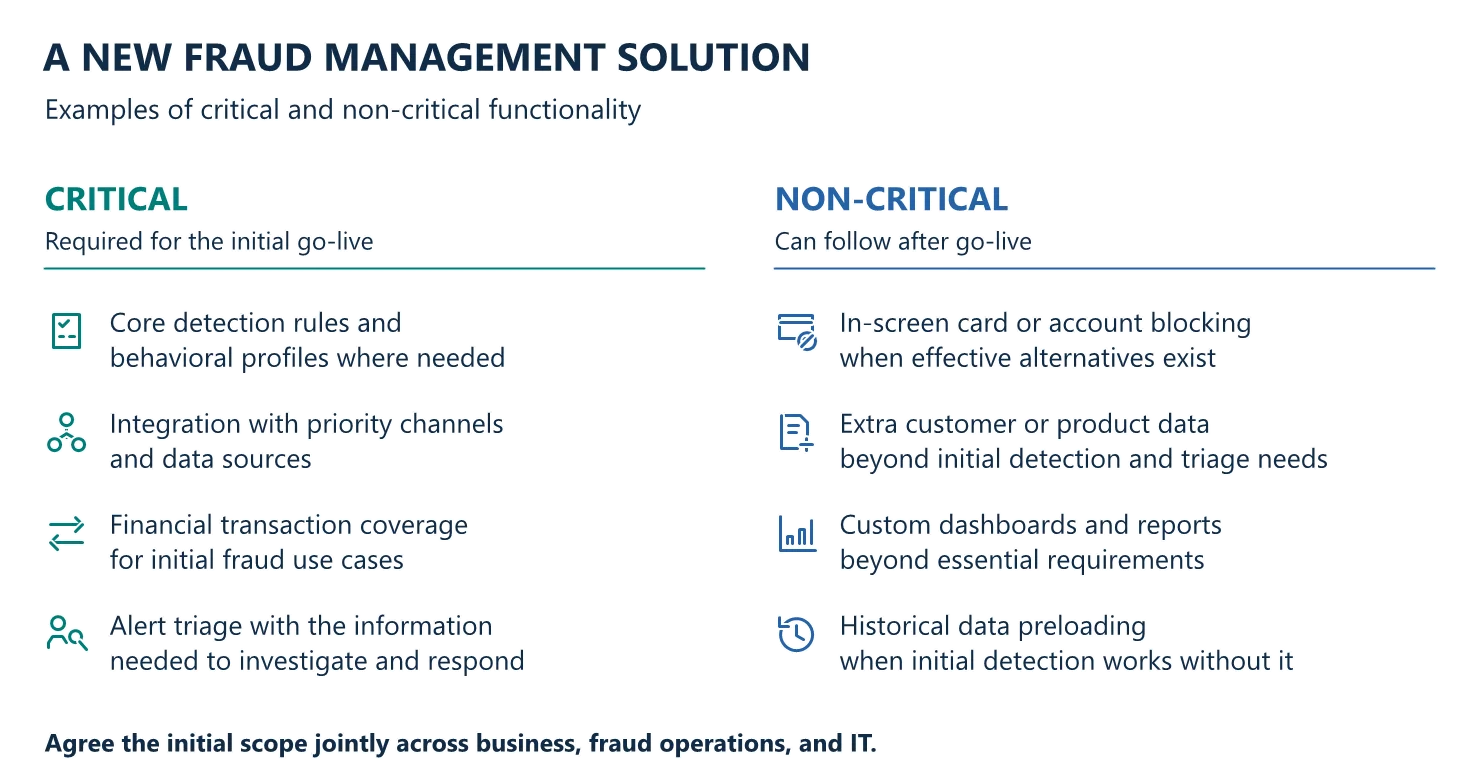

Examples of critical functionalities:
  • business rules based on behavioral profiles,
  • integration with relevant channels,
  • integration of all financial transaction types we need to assess and monitor,
  • triage interface with a 360° view of customer details along with his/hers products, etc.
Examples of non-critical functionalities:
  • the integration of analyst actions like blocking the card or account directly from the analyst's view
  • enrichment of integrated transactions with additional details related to customers or products,
  • specific dashboards, reports, etc.
