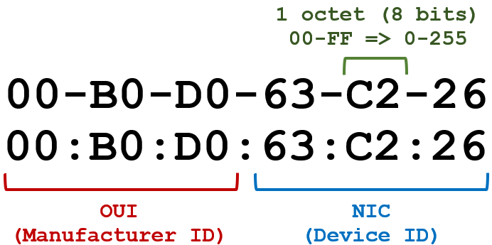

The manufacturer and device-specific parts of a MAC address.
Figure 1: The manufacturer and device-specific parts of a MAC address.
A MAC address is a unique, 12-character alphanumeric attribute that identifies individual electronic devices on a network. An example of a MAC address is 00-B0-D0-63-C2-26. The first 3 pairs (Block ID), 00-B0-D0, identify the manufacturer; in our example, DELL. A single manufacturer can have many - even hundreds of Block IDs assigned. The remaining 3 pairs (63-C2-26) represent the device's unique ID. MAC address identifies the device, but in reality, it is imprinted/pre-assigned to the machine's network card/interface. So if your machine has multiple network interfaces, it will have multiple MACs, one for each. Though the MAC address is pre-assigned by the manufacturer, it is possible to spoof/alter it.

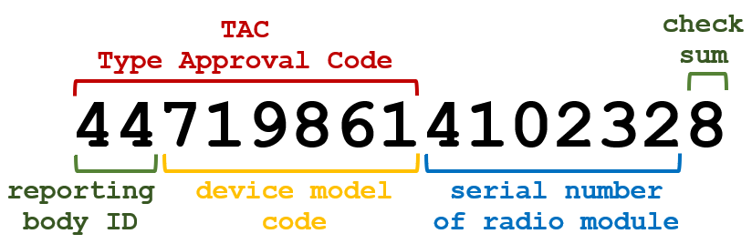

The structure of an IMEI number.
Figure 2: The structure of an IMEI number.
The IMEI number is a unique 15-digit serial number assigned to every mobile phone, which can be used to check information such as the phone's manufacturer and model number.
Identifying devices via MAC address or IMEI number is no longer straightforward. As the general public is getting more conscious about their online privacy, these IDs became the first to be blocked or made unavailable exactly for the reasons for which they actually exist - exact identification of the device and, in the online world, attribution of the online user/device.

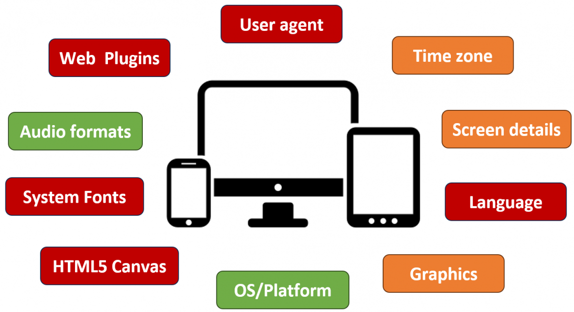

Examples of browser and device characteristics used in fingerprinting.
Figure 3: Examples of browser and device characteristics used in fingerprinting.

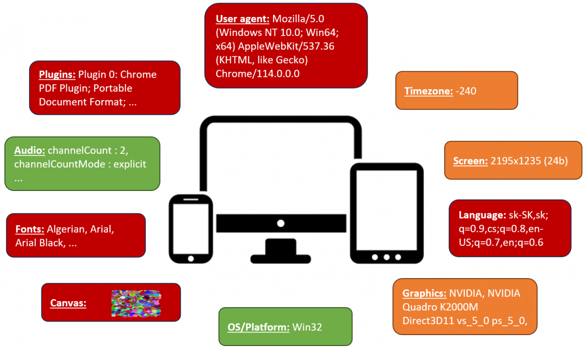

The above diagram shows the most common ones, but the browser can gather tens or even hundreds of other characteristics when a user loads a web page1.
Some of these characteristics are not very unique - like OS/Platform, where only 3-4 platforms are being used- but others could be very specific, like Canvas or browser version and details. By combining multiple unique characteristics, we can identify a particular device with very high accuracy using only a few characteristics.
On the diagram below - with actual sample values for given characteristics - you can see how different characteristics and their combinations can narrow down the pool of possible devices as the final combination becomes extremely specific and, therefore, rare (color distinguishes the uniqueness of the information from green=low to red=high). Based on the example, it is clear that to reach (ideally) a unique fingerprint, we must combine several characteristics.
Combining characteristics narrows the set of matching devices.
Figure 4: Combining characteristics narrows the set of matching devices.
In the example above, the language preference (per my device) is set to Slovak (sk-SK). This narrows the pool of devices significantly, but that is because the Slovak language is used by a relatively small number (a few million) of devices by people from my home country. On the other hand, if your preferred language is English, you narrow the pool only slightly, since more than 75% of users prefer English.

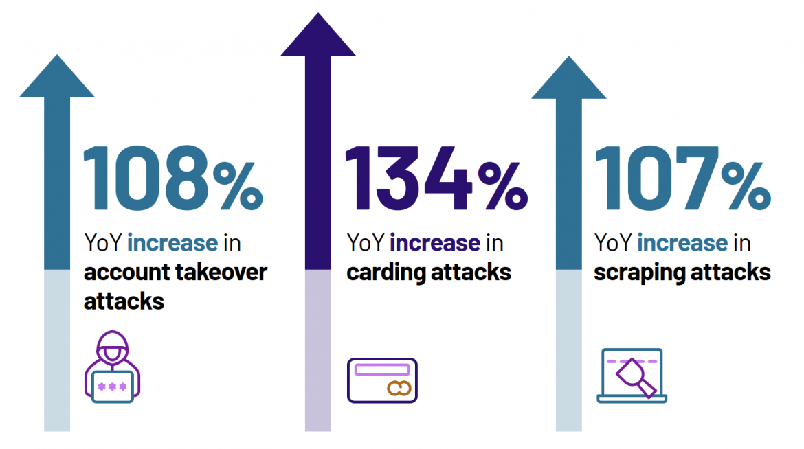

Reported changes in malicious bot activity, including account takeover.
Figure 5: Reported changes in malicious bot activity, including account takeover.
The above graph shows the increased use of Bots for malicious activity, but the very first item - an increase of 108% for Account Takeover (ATO) attacks is the one we want to highlight2.

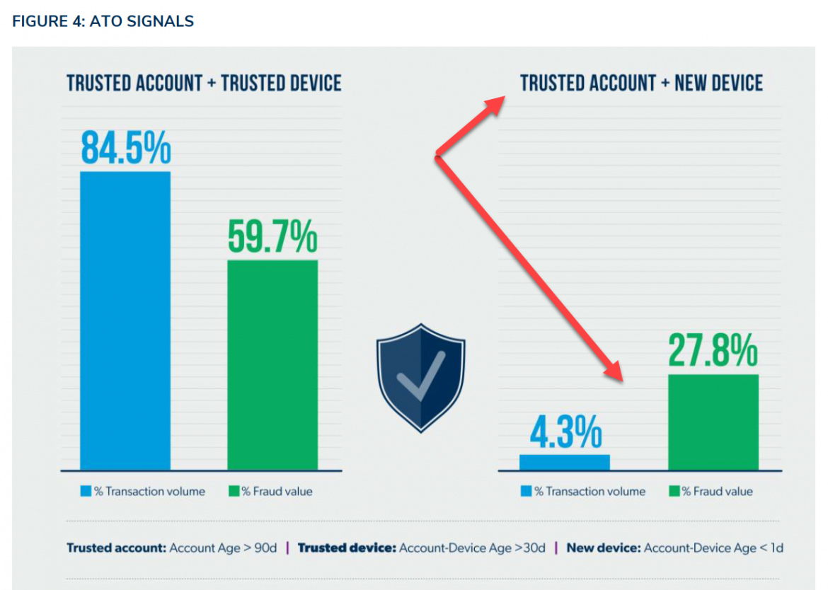

Aite-Novarica and Outseer3 also released more exciting graphics that show how disproportionate fraud is when we consider the combination of an existing account and a new device. The volume is very low, but the fraud ratio within these few transactions is high.
Fraud distribution by existing or new account and device combinations.
Figure 6: Fraud distribution by existing or new account and device combinations.
Another scenario is SIM swap fraud. Would it help if you could identify that the user has logged in from a different/new device? I bet it would. Another use case is the same Device ID used by multiple customers - some False-Positives might occur, but this would certainly lead to some very interesting findings, and the last one: building the Device Fingerprint/ID-based blacklist/watchlist.
