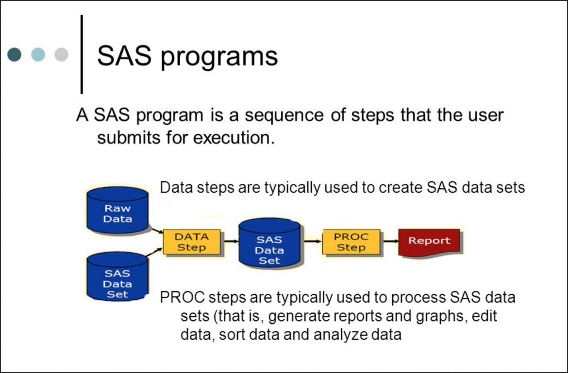

SAS programs combine DATA steps and PROC steps.
Figure 2: SAS programs combine DATA steps and PROC steps.

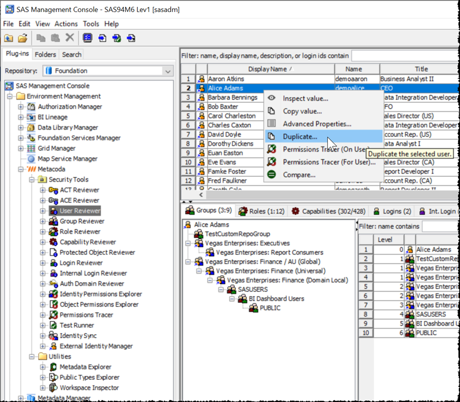

  1. Metadata management - a unified place to address a range of tasks like solution user management, roles, and access privileges, data source registration, scheduling, backup and auditing configuration, and many others
User and metadata management in SAS Management Console.
Figure 3: User and metadata management in SAS Management Console.

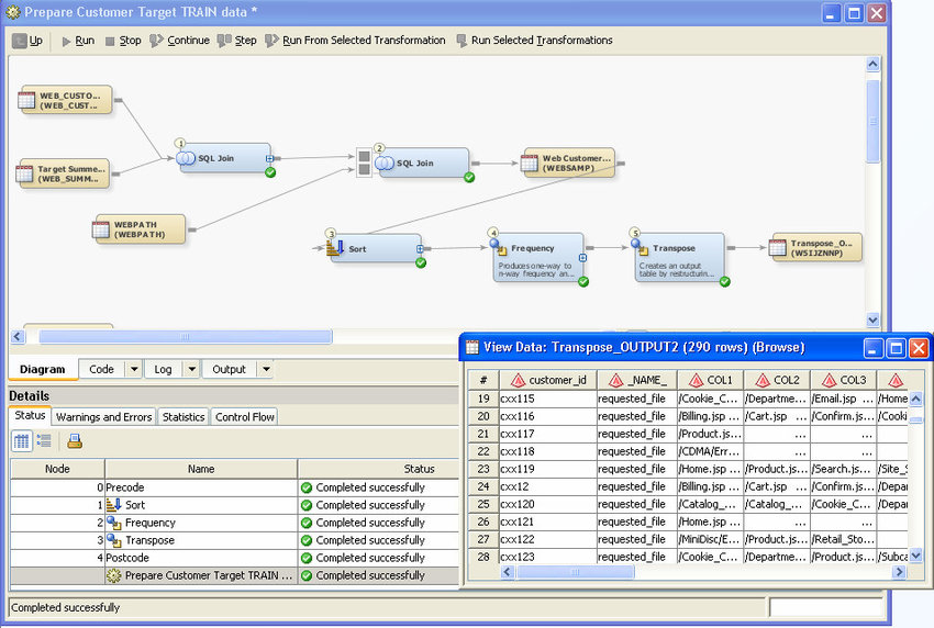

  1. Data integration solution for managing the ETLs and data flows within the solution, batch processing and scheduling, data lineage, and others
An example data-integration workflow in SAS.
Figure 4: An example data-integration workflow in SAS.

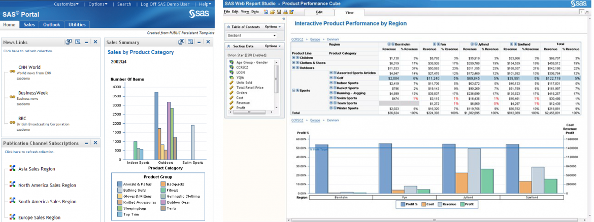

  1. Web Reporting and Dashboards to present and deliver the data, reports, or dashboards across the organization
Examples of SAS web reporting and dashboards.
Figure 5: Examples of SAS web reporting and dashboards.

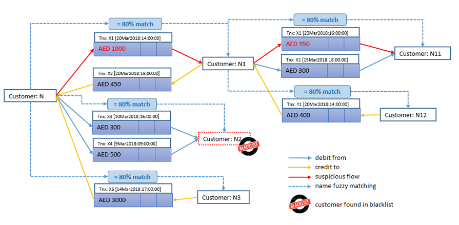

Let me give you a practical example of using SAS tools to solve an actual POC use case in the fraud domain. Our task was to identify cycles (cyclic transactions) among corporate customers with intent to build good credit history, resulting in application fraud.
A transaction-network example for identifying potentially suspicious cycles.
Figure 6: A transaction-network example for identifying potentially suspicious cycles.
Rule limitation/parameters:
  1. Amount of transfers between customers to be within +/- 10%
  2. Applicable only to corporate customers’ transactions
  3. Customers to be matched through name rather than actual ACCOUNT_NUMBER
  4. Name to be matched using fuzzy matching technique
  5. Customers to be matched against Blacklisted customers list
  6. Algorithm depth level - L2 - L5
  7. L1: A > A [me-to-me transactions were excluded as non-relevant]
  8. L2: A > B > A
  9. L3: A > B > C > A
  10. L4: A > B > C > D > A
  11. L5: A > B > C > D > E > A

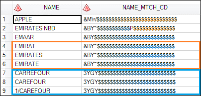

The first part that could raise an eyebrow would be fuzzy matching of the names, but not for SAS, as we could use one of the many fuzzy matching techniques available within the platform:
  1. Generalized distance
  2. Levenshtein distance
  3. Asymmetric spelling distance
  4. Regular expressions
  5. SAS Data Quality solution leveraging Match codes
Name variants grouped using SAS Data Quality match codes.
Figure 7: Name variants grouped using SAS Data Quality match codes.
In the final solution, we used SAS DQ Matchcodes primarily for easy accuracy adjustments.

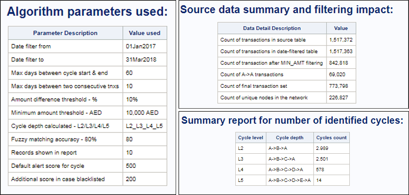

The second tricky part was identifying the cycles. We identified more than one way of doing this - we tried and implemented three alternative solutions as we wanted to provide the one with the best performance. Three variants comprised of
1) Finding cycles using SAS Social Network Analysis tool
+ specifically designed for network analytics and application of network algorithms
- required post-processing as time constraints and amounts were not possible to filter within the algorithm
2) Finding cycles using SAS programming language (data step + macros)
+ custom-designed and built with all filtering conditions considered (applying conditions = Name, Amount filtering, etc.)
+ required very little storage space
- required a lot of CPU resources, and execution time grew exponentially
3) Finding cycles using SAS SQL [selected solution]
+ applied the filtering conditions and allowed easy manipulation and alteration of code
+ was by far the fastest of all algorithms
- required relatively high storage for execution
Algorithm parameters, source-data summary and identified transaction cycles.
Figure 8: Algorithm parameters, source-data summary and identified transaction cycles.
In the pictures above, you can see that the final solution was assessing approx. 1.5M transactions, among which numerous cycles have been identified. Although the report doesn't capture the algorithm's speed, execution for the above scenario took less than 1 min.
