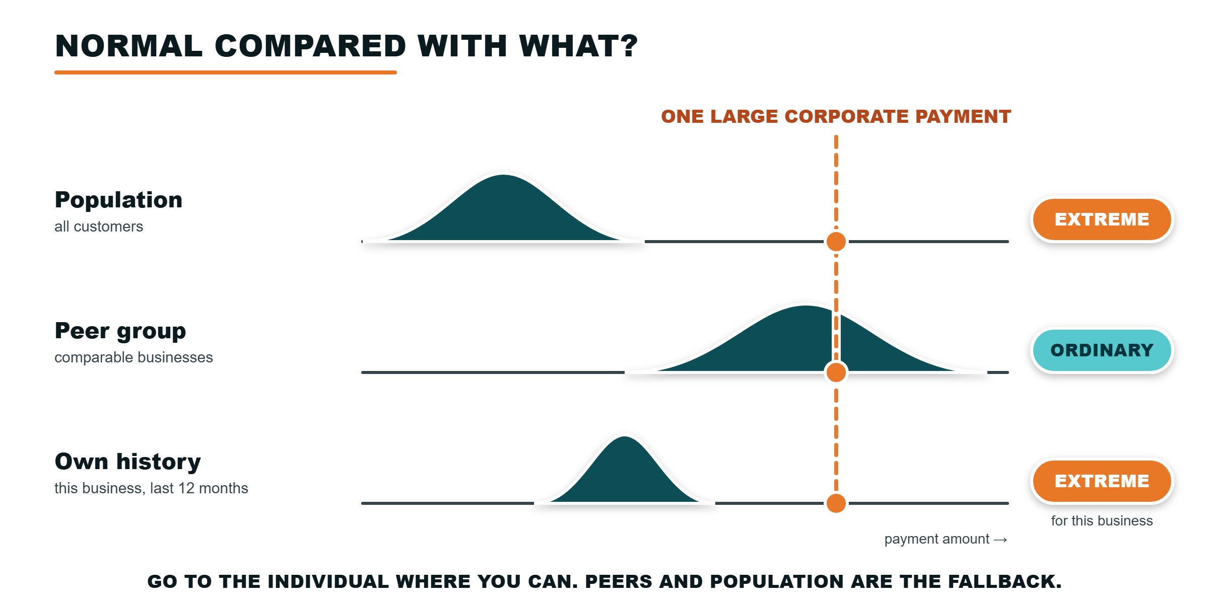

The reference can sit at three levels: the whole population, a peer group of similar customers, or the customer's own history. A large corporate payment can look extreme across all customers yet ordinary among comparable businesses, and ordinary for comparable businesses yet extreme for this one. Which level you end up with mostly depends on technology. Population thresholds are easy to set; a profile for every customer, updated as they transact, takes a platform built for it. Where you have the choice, go to the individual. Peer groups and population baselines are the fallback for customers with too little history, not the default.
Figure 1: Normal compared with what? The same corporate payment can be extreme across the population, ordinary among peers, and extreme against the customer's own history.
The unit matters too: a single amount can be ordinary while a burst of similar payments is not. Clustering helps build peer groups, but on its own it isn't fraud detection. It becomes evidence only when you read a departure against those groups.

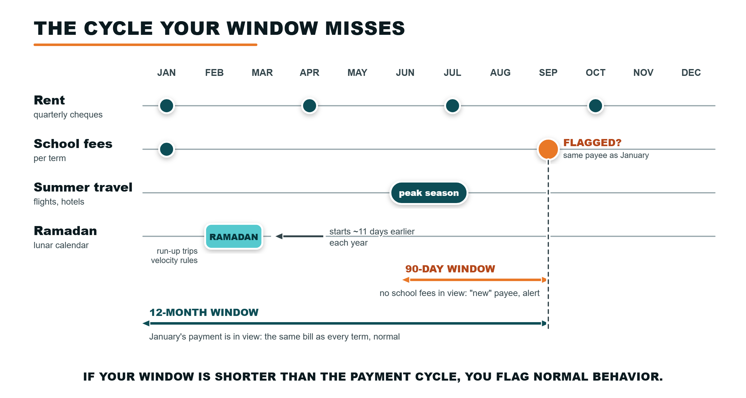

Take the GCC, where I've worked for over thirteen years. Rent is often paid in large lumps, quarterly, twice a year, sometimes a full year up front. School fees arrive the same way. Every summer, a large share of residents book flights and hotels within a few weeks, in a merchant category most fraud teams already treat as high risk. Measured against a 30- or 90-day baseline, each one is a textbook anomaly: many times the customer's usual amount, to a payee they haven't paid in months. Nothing about it is suspicious. The customer does the same thing every year.
Ramadan stretches "usual" further, and it starts before the month itself. In the run-up, households stock up, buy gifts, and settle bills, so the number of transactions in a short window rises sharply, which is exactly what velocity rules count. During the month, spending moves into the late evening and night, and charity and family transfers rise. Because Ramadan follows the lunar calendar, it starts about eleven days earlier each year, so a baseline that learned last year's March as normal is now looking at the wrong month.
Figure 2: The cycle your window misses. A 90-day baseline can miss an earlier school-fee payment; a longer history reveals the recurring cycle. Seasonal events also need calendar context.
The lesson I'd take from this: if your baseline window is shorter than the customer's payment cycle, you will keep flagging the normal behavior.

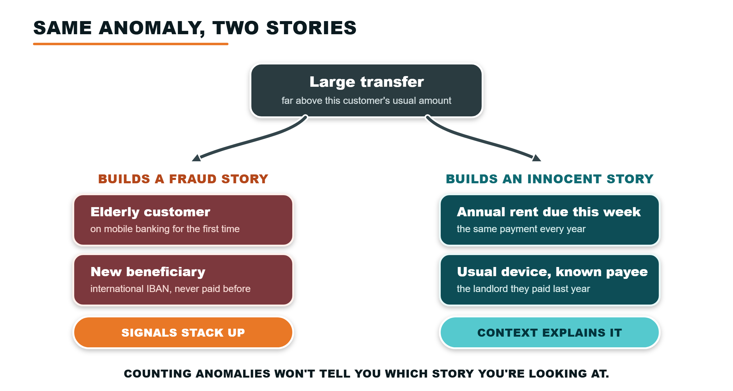

So where should the line sit? I don't think there's a generic answer. It comes down to the scenario and the context you can gather. Sometimes a single anomaly is enough to stop a payment, when its size or its deviation from normal is large enough to carry high confidence on its own. More often, what matters is how ambiguous the anomaly is. "The customer is using a channel they've never used before" tells you very little. "An elderly customer is using mobile banking for the first time, and the beneficiary is a new international IBAN" starts to tell you a story.
That's the real test. More anomalies don't automatically mean more risk. Some build toward a fraud story. Others build toward an innocent one: the large transfer in the week the annual rent is due, from the customer's usual device, to the landlord they paid last year. Counting anomalies won't tell you which story you're looking at. Reading them together will.
Figure 3: Same anomaly, two stories. A large transfer can support a fraud concern or a legitimate explanation, depending on the customer, beneficiary, timing, and device context.
