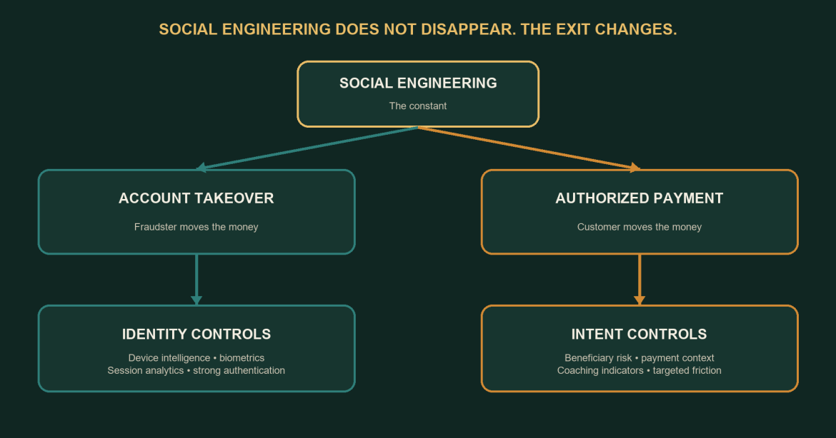

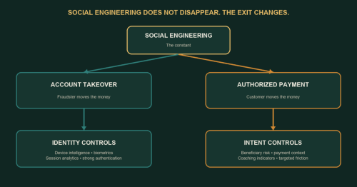

Here is the part that gets less attention. Social engineering unfortunately does not stop working when you close one door. It relocates to the door still open.
Two Doors, and One of Them Is Being Bricked Up
Every social engineering attack in retail banking ends in one of two outcomes.
FIGURE 1: Stronger authentication reduces the yield from account takeover, but it does not test whether a customer's payment intent is genuine.
The first is account takeover (ATO). The fraudster gets into the account and moves the money themselves. A lot of what the industry has built over the last fifteen years attacks this: device intelligence, behavioral biometrics, session analytics, step-up authentication, and now the passkeys and biometrics that 3057 mandates.
The second is authorized push payment (APP) fraud. The fraudster never touches the account. The customer is deceived and manipulated into making the payment personally, on their own device, through their own genuine banking session.
Account takeover is getting materially harder. I want to be careful here: it is not solved, and anyone selling you that is overreaching. Remote access tooling still degrades device signals, and adversary-in-the-middle techniques are advancing faster than most detection stacks. But harder and more expensive is enough. Fraud is a business with an ROI, and when the cost of one route rises while the payoff stays constant, the volume simply moves. Whether this door stays shut is a separate question, and one I suspect we will be revisiting.
What does not happen is the attacker giving up. Social engineering itself shows no sign of losing its edge: the FBI's Internet Crime Complaint Center recorded reported phishing losses growing 208% in 2025 while complaint volume remained broadly flat, moving from about 193,000 to 192,000. Complaints are not the same as unique victims or attempts, so the figures cannot establish a per-victim extraction rate. They do show that a familiar social-engineering category continued to produce sharply higher reported losses without a corresponding rise in complaint volume.
So the capability is intact and improving. Only the exit changes. And it moves to the route where the bank's controls are not merely bypassed but completely missing.

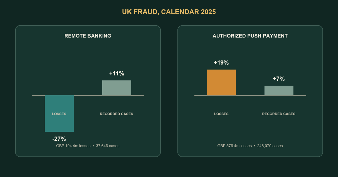

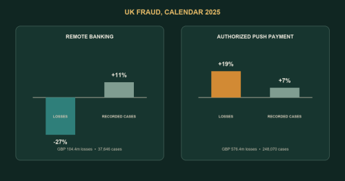

FIGURE 2: UK Finance data for calendar 2025 shows remote-banking losses falling as recorded cases rose, while APP losses and cases both increased.
The argument lives in the gap between the first two remote-banking measures. More recorded cases. Far less money. That is consistent with a control environment reducing fraud yield even when it does not eliminate activity. Web losses specifically nearly halved, down 46% to an all-time low, on effectively flat case volume.
Now the other door. Strip out cards, and the picture is stark: in UK non-card fraud, APP is now more than five times the size of remote banking fraud and moving in the opposite direction.
There is an apparent contradiction here, and it needs clarification. On 1 July 2026 the PSR published an independent evaluation of the reimbursement regime's first year: the policy cut APP losses by around GBP 73 million annually, avoided roughly 35,000 scams, and reduced APP fraud over Faster Payments by about 21%.
So the policy worked. And APP losses still rose 19%. Both are true, because the PSR figure measures against what would otherwise have happened. The intervention slowed the trend rather than reversing it. And that is the shift we expected and expect even further in the future- a shift from ATO to APP.
That is the sobering part, and the reason to cite a market that is not ours. In a country with strong authentication rules, a mandatory reimbursement regime, and an independent evaluation confirming that regime works, authorized fraud still grew by a fifth in a year. The comparison does not prove that stronger authentication caused APP losses to rise, because the markets, reporting rules and policy environment changed at the same time. Where authentication is hardened, takeover yield can fall sharply while authorized fraud continues to grow.

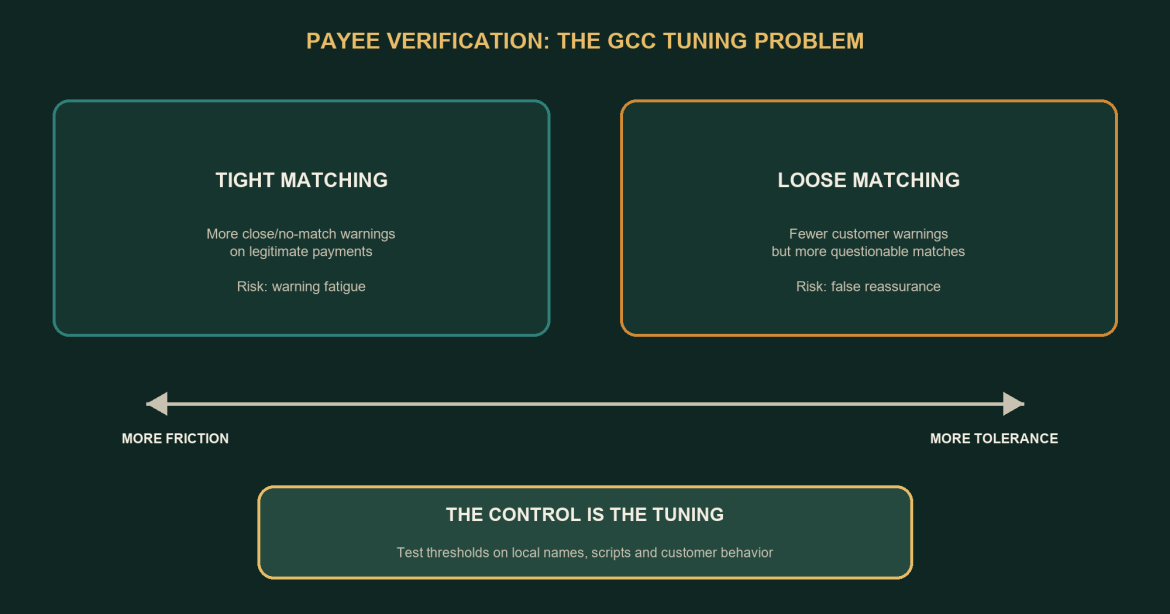

The result is not that payee verification fails more often. It is that the gray area in the middle becomes enormous.
That gray area is where the harm lives, and there is no tuning that fixes it:
FIGURE 3: Payee-name matching in the GCC creates different failure modes at tight and loose thresholds; neither can be managed safely without local testing.
Anyone who has spent time on fuzzy matching in sanctions screening knows this shape of problem: the tuning is the entire product, the thresholds are market-specific, and a threshold imported from another market is not a starting point; it is a liability. Payee verification here is a genuine engineering problem that deserves genuine engineering effort. Adopting it on the assumption that it is cheap is how you end up with a control that is sometimes worse than no control.
